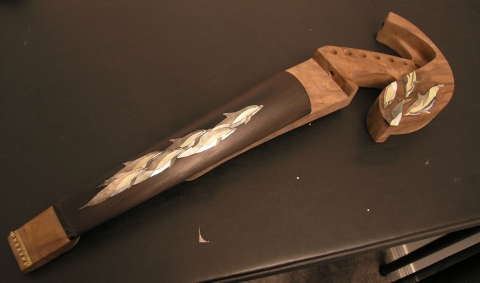

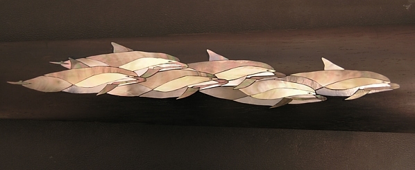

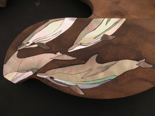

Well after a lot of debate this turned out to be the final piece. It's one of the toughest inlays I have done yet (over the fingerboad that is). It was done all with basically .06 shell, and the radius was like inlaying over a baseball bat. It's a hybrid 7 string violin/viola.
I had to go in multiple times and re-cut, re-size, then after it was all inset and glued I had to go back in yet again and route out two large gold pearl slightly sub-level pieces and replace them, then re-sand.
It took many, many hours.
Visit it at NAMM if you go.
Thanks for looking!
If you ever see something like this on a violin anywhere let me know. I would be surprised!

there along with it's first in the series piece of marine life violins - the sea turtle with jellyfish inlay I did for him a few years back.
More inlays soon

Truly Amazing work Craig!! Love the dolphins on the fingerboard

the radius curve on the fingerboard to show it to you. It's not a typical 4 string violin.
It's a 7 string hybrid. Imagine taking a styrofoam coffee cup and pushing the sides in about 4 mm each, that is what the curve is like at the end.
Yes I have seen Amy Hopkins work on violins. It's really nice, but she used a lot of recon on that one (easy to get very thick) and she heat bent a lot of it. Something you can't do with shell. I spoke to her about it at the last ASIA symposium. She's as nice as the day is long, and a great inlayer as well. She actually has her young student doing most of her cutting for her now, so she is more of a team effort than an individual.
I was happy with this piece that with all the sanding issues, curve, etc.. my black pearl stayed black, and my gold pearl stayed gold. I spent extra time searching for the best most color-through pieces.
